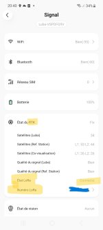

Today i setup a Mammotion LUBA 2 and i see a LORA use icon in the menu, but did it use it ???? LORA is also good in long range transmission and you can find it on some ESP32 module
So main test : Are you sure that WIFI is present everywhere in your garden ????
