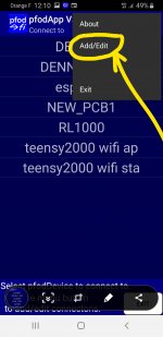

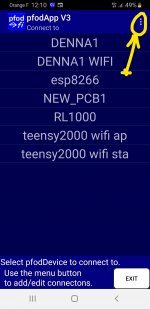

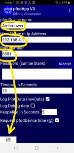

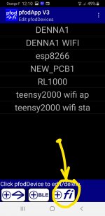

For pfod follow the screenshot , Your phone need to be connected in WIFI to your Live box or to ESP32 if you use AP.

The buzzer is a 4 to 6.5VCC but I gave 8881 instead of 80 on port, as you wrote, and the connection is now ok ! :D
