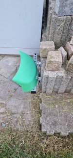

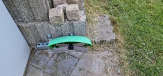

Yesterday I prepared the Docking station. I used the upper part of the old Robomow dock and screwed it on a metal frame. Unfortunately I could not get the mower to charge. How will the charge switched on by the sunray FW? I see the green LED on the Power board is ON and I have tested the MosFet before. @Bernard can you help me again? Thank You. :)

What is the status of mower (DOCK or IDLE) when into station.
Take a look at the Voltage and sense into sunray or Cassandra
When sense is negative battery is in charging mode
Charge start only if voltage is below 26V
You can change permanently this value into battery.cpp line 58
or for test setting (reset after a reboot) send :
AT+CT,8,23.5,0
if you want that charge start at 23.5V for example.
IT'S BETTER TO HAVE A FIX in the station ,and i see that you are near a wall !!!!!

Thank You, I will try this out. Depending on the LFP-battery, I need to degrease the start voltage to a lower level.
The wall is 1m of height only, I hope this will work, otherwise I change the location.

So, I adjusted the values and it works fine :D
If the battery goes empty, the mower returns to the dock and starts charging. Great.
